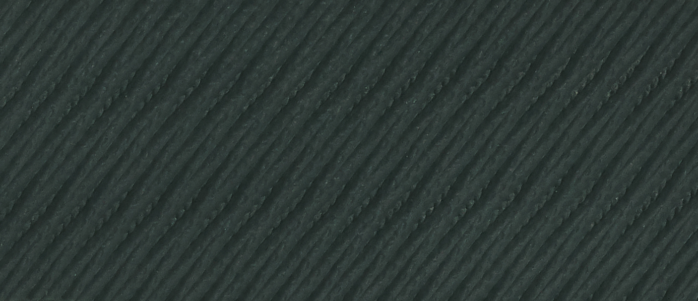

PEEL PLY CARBON FIBER
Carbon fiber-filled, epoxy resin lay-up that has textured material placed on the surface to protect the material during manufacturing. After manufacture, the material is removed and it leaves a grippy texture in the epoxy making a non-slip handle material.
