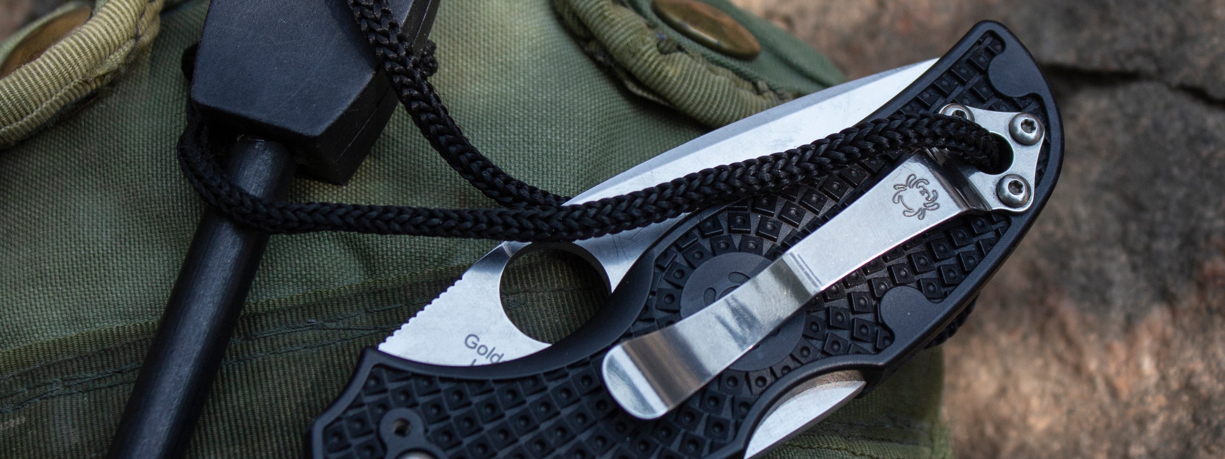

Volcano Grip™
One of Spyderco’s signature texture patterns, the Volcano Grip texture consists of a grid of small, raised squares with a recessed dimple in the center of each. Found on Spyderco knives featuring injection-molded FRN handles, it offers secure, slip-resistant control during use.
