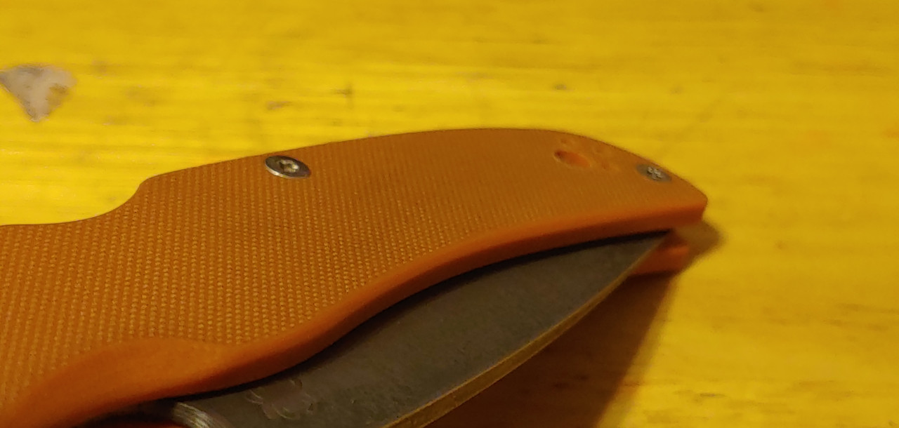

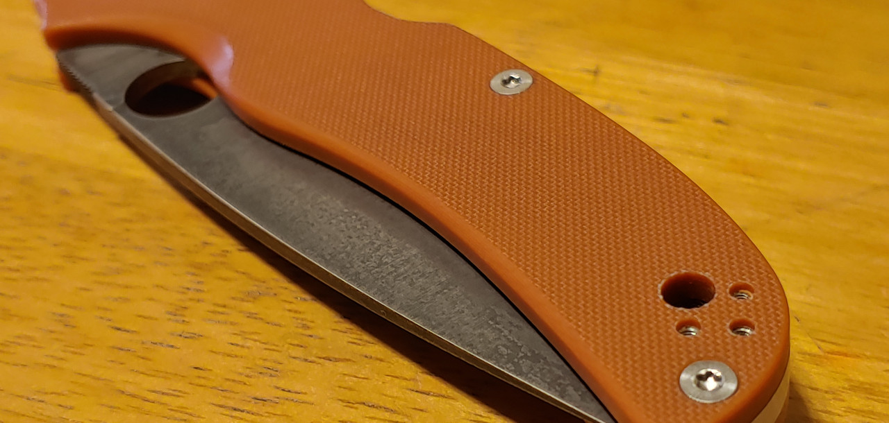

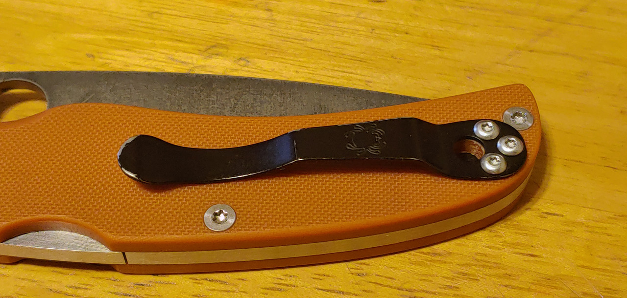

I will start with my Native 5 mods.
Here ere are the photos of my modded Native 5.
Aesthetically, it may not look as good as an unmodded Native 5, but it is now much more comfortable to use in every way (hammer with choil, hammer w/o choil, saber with choil, saber w/o choil, pinch grip, precision grip, reverse hammer grip, chest lever grip).
I removed the spoon pocket clip and don't plan on replacing it. The knife fits perfectly in the fifth pocket of my pants (tip down is my preference). No need for a clip or pouch.
A list main scale mods are:
(1) ramps from the pivot to the blade tang
(2) removing scale material behind the choil to make arc of the curve match that of my finger and create enough space for a full 4 finger grip behind the choil
(3) flattening the "palm swell" bump
(4) rounding all of the edges
(6) sanding down the bidirectional texture.
Note: "Finish" was done with 60 grit sand paper. Further discussion of scale mods can be found at viewtopic.php?f=2&t=89845
I reprofiled the edge of the Rex 45 blade to 13 deg per side, which is as low as I could go with the KME system that I own. No issues with chipping or rolling thus far.

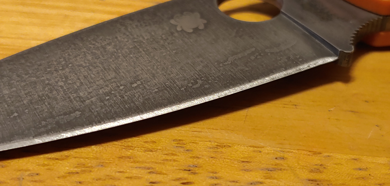

Re: Native Series Knife Mods and Inspire Others

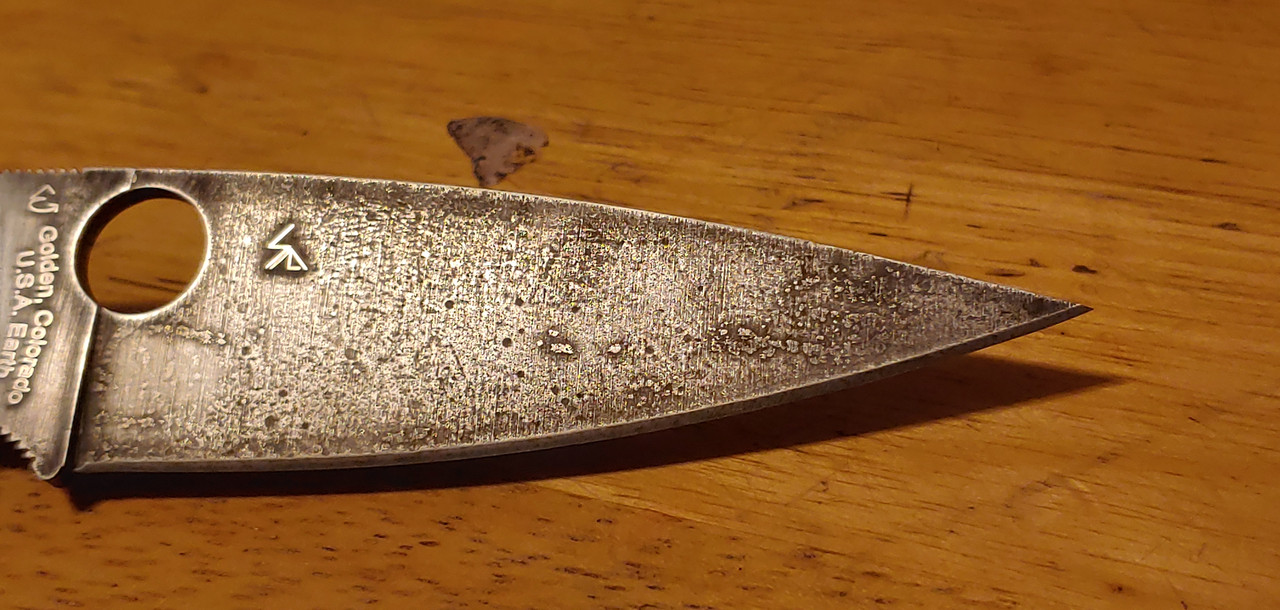

This happened 3 years ago after vinegar forced patina. Probably alien existence proof.

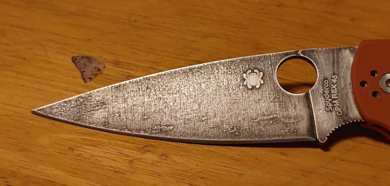

Rex45 Chief
Black clip because they look better.
Contoured the scales a bit because they felt too squared off from factory.
Forced patina with vinegar.
Gave is a coarser edge finish.
Can't see it but I also polished up the internals making the action extra smooth.
Karl, funny seeing you mod the palm swell that way. Back in the day I had the original Native, and I modded the palm swell to resemble what the Native 5's look like.
You took it one step further!
Doing that mod helped me get a full grip behind the choil, so I'm sure yours does a good job too.

Nice work! I didn't have much interest in forcing a patina on my REX45 blade, but your photos have inspired me to give it a shot.

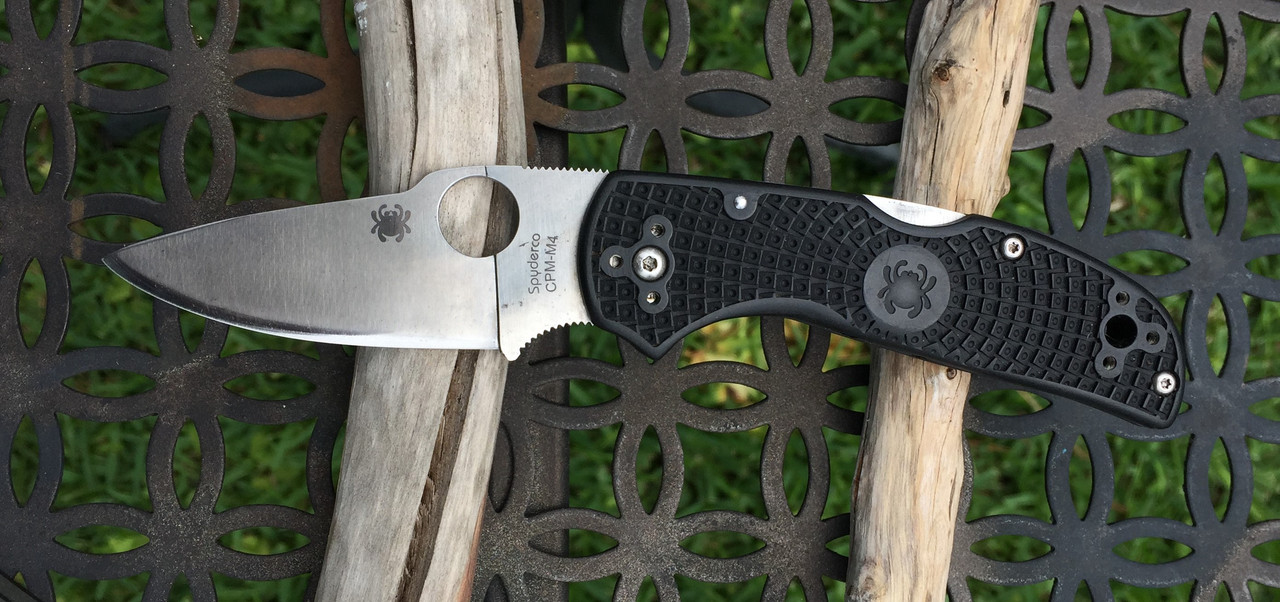

Cerberus Worker Shaman

Karl, I am a big fan of your mods.
I really understand #2, making the radius of the guard match your finger radius. That's a big thing for me too. (7/16" finger radius for me.) I raised the radius issue in a post some time ago and NOBODY was sympathetic with it, so it must be just you and me, pal.
See: viewtopic.php?f=2&t=89207
If you look at the mods I made to my backpacking Mule you'll notice I did the same exact thing: Decrease the radius of the guard curve. Makes a major comfort difference for me and it effectively "lengthens" the handle by allowing your finger to grip closer to the blade.
#3 also. I did same flattening of the "pregnant cow" shape of my backpacking mule. No discrespect to pregnancy or cows, I like them both. Just sayin' I don't need so much palm swell. I don't have a huge hollow in the palm of my hand that needs filling.
#4 I also did to my Mule, but then, it's a mule, with no rounded edge whatsoever.
So: What method did you use to modify the arc/radius of the guard?
