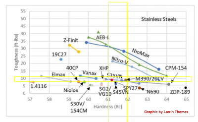

After reading Larrin's and BBB's stats for the knife, I've attempted to "box" the area where SPY27 lives on Larrin's toughness x hardness graphic. I've seen hardness listed from Rc 61 to 62, and toughness from (avg) 8 to 11 ft lbs. From this perspective, it looks to be M390-ish, S35VN-ish.
Wouldn't surprise me if the steel performed better on less abrasive cutting, given its carbide volume isn't huge.

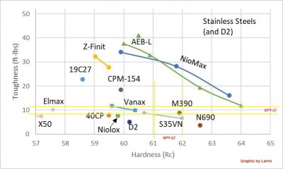

Silly me. Larrin himself put a dot on a newer chart to represent SPY27. The yellow "box" was added by me. Larrin's Rc test was around 61 and BBB's was 62. I think the 62 was as-delivered from Spyderco, and the 61 was Larrin's own treat, is that correct?
62rc is what was measured on the para 3 LW
The Catra testing Blade is 61.8 rc which will be a great representation of what Spyderco runs it at.
