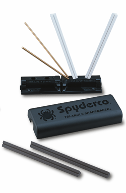

204MF Tri-Angle Sharpmaker
![Spyderco 204MF](http://www.spyderco.com/byte/march2012/images/204MF.png)
The 204MF Tri-Angle Sharpmaker set includes: two medium-grit brown triangle stones, two fine-grit white triangle stones, an ABS plastic base with lid, two brass safety rods and instruction booklet and instruction DVD. The patented triangle stones sharpen PlainEdges on their flat sides and SpyderEdges (serrations) using the corners. Running the length of each stone is a groove for sharpening pointed tools such as fishhooks, awls and punches. Keyed slots in the ABS plastic base pre-set the stone's angles to sharpen on a 30° (15° each side) -or- a 40° (20° each side) setting. Two brass rods inserted into the smaller round holes act as a safety-guard, blocking a blade being sharpened from accidently sliding off the stone and cutting the hand holding onto the sharpener. A cutout on the side of the base holds a single stone at 12.5° for sharpening straight-edge scissors (using the stone's flat side) and pinking shears (using the corner of the triangle). On the underside the base, two stones can be placed side-by-side (flat side up) to make a large benchstone surface for honing large sharps. The lid snaps half-way across the base, creating a stabilizing handhold to grip while sharpening, or the lid can completely cover the base with the stones and brass rods inside for portable on-the-go sharpening. Sharpening base can be permanently bolted to a counter-top or workbench. An accompanying instruction book and DVD show you how to use the 204 to sharpen PlainEdge and serrated knives, household implements, industrial and sporting tools. Made in the U.S.A.

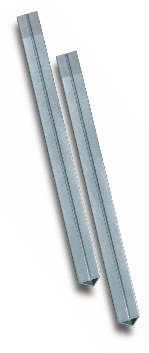

204D DIAMOND TRIANGLES
It's long been known in the cutlery industry that diamond coated sharpening devices work best for aggressively re-shaping and profiling excessively dull and worn blades. Spyderco offers a set of diamond-coated triangular-shaped rods. The diamond triangles fit into Spyderco's existing 204MF Tri-Angle Sharpmaker system, sell separately as an accessory and enable the system to sharpen most anything. Hollowed out to lessen overall weight, each rod is seven inches long and the three flat (triangular) sides are half an inch wide. Made of nickel-coated steel and plated with microscopic diamond particles, they are moderately coarse at 400 mesh and capable of removing a great deal of metal quickly during sharpening. Running the length of each rod is a channel for honing pointed items such as fishhooks, awls and darts. The three corners of the triangle make quick work of re-beveling serrated edged cutlery and the flat sides effortlessly whet plainedges. An inch along the bottom of each triangle is not diamond plated allowing the rods to smoothly slide into the Sharpmaker's base. Highly recommended for aggressive sharpening, re-beveling and reshaping only. Clean them after use by rubbing off with a dry cloth. Sold as a pair.
