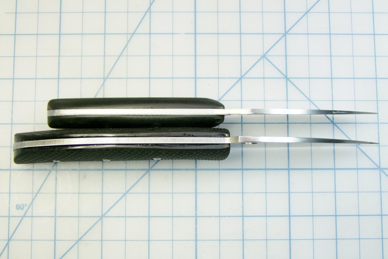

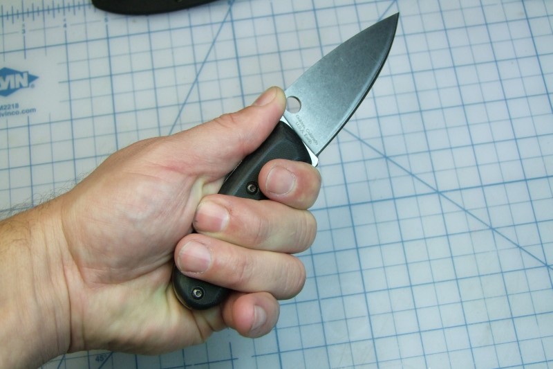

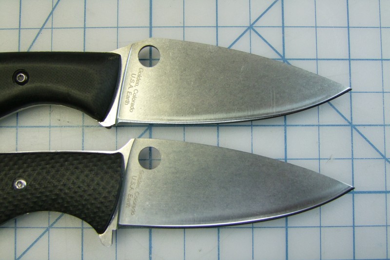

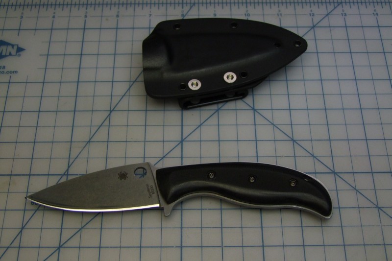

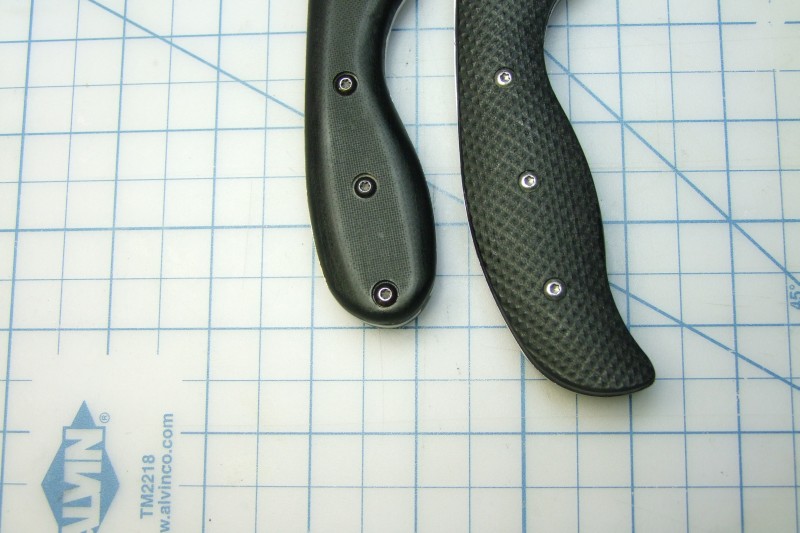

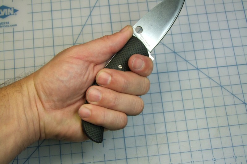

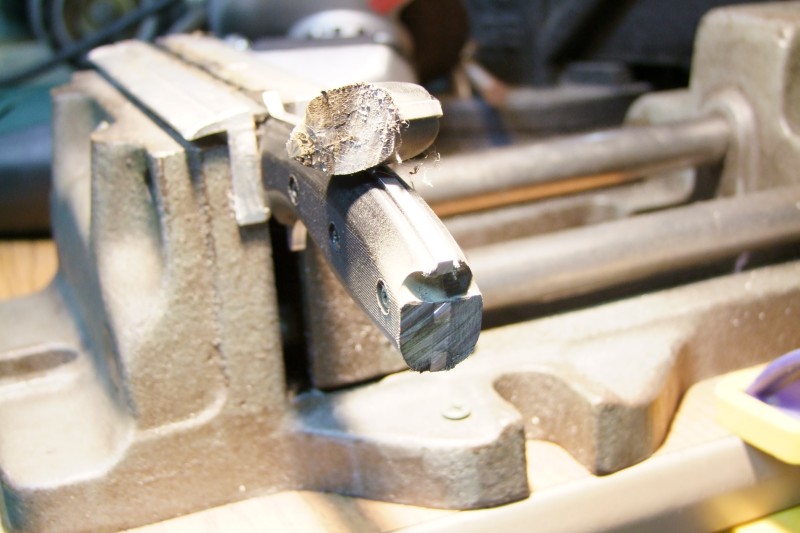

    Given the outstanding quality and attention to detail that many of you give your mules when putting scales into them, I have to admit I am a little embarased about showing these pictures as my "shorty" mule is not pretty, but boy does it feel great in the hand.
    Here is what one of my MT11 (M390) mule looked like a while back. I had gotten these undersized scales in black Micarta last year, and I got them installed and epoxied about 2-3 weeks ago:
    But it never felt "right" - it felt too handle heavy and I could not get my hand as far upfront as I wished, so I decided, in the spirit of having the mule as a test vehicle, to trim it and change the ergonomics to suit my hand:
    In these next few photos I am not done with the minor profiling/sanding, but you can see the size of my shorty mule in my left hand (I am a lefty, so I am taking pictures with my right hand):
    Here is my other "normal" MT11 Mule with Halpern Titanium Typ4 4 scales:
    And here is my shorty:
    And here a shot of both normal and shorty:
    As I mentioned earlier, the shorty feels great in the hand, still a little bit handle heavy, but much better balanced. I now have to send it to Scott Gere for a new custom sheath.
    Will
