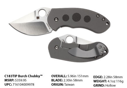

One of his most popular custom models is his Chubby folder—a stout, folding knife that packs an impressive amount of cutting edge into a compact package. Its popularity and distinctive design made the Chubby the perfect platform for Spyderco’s first Michael Burch collaboration.
The Burch Chubby/Spyderco folder is wide and thick in comparison to its length with satisfying hand-filling heft. Its broad blade is precision machined from 0.175-inch (4.5mm) CPM S30V stainless steel stock for extreme strength and durability. This thickness is offset by the blade’s wide profile, a deep hollow grind, and a pronounced swedge on the back. Collectively, these features complement the blade’s long, sweeping cutting edge to provide exceptional edge geometry and cutting performance that far exceeds its compact size. Spyderco’s Trademark Round Hole™ completes the package and guarantees immediate blade access.
The handle defines the knife’s short, stout character while providing plenty of purchase for a good grip. It is constructed of two solid titanium scales joined at the end by a G-10 back spacer. The obverse scale features three precisely fitted round carbon fiber inlays that contrast with the matte gray color of the bead-blasted titanium. The other scale houses the knife’s sturdy Reeve Integral Lock (R.I.L.) mechanism, which locks the blade securely into place when opened. The carefully machined relief cut for the lock is located on the outside of the scale to ensure a straight-line force vector for maximum lock strength and reliability, while still allowing easy one-handed operation. To ensure convenient carry and easy access, the Burch Chubby includes a custom-designed, broad-profile clip that is configured for right-side, tip-up carry.
